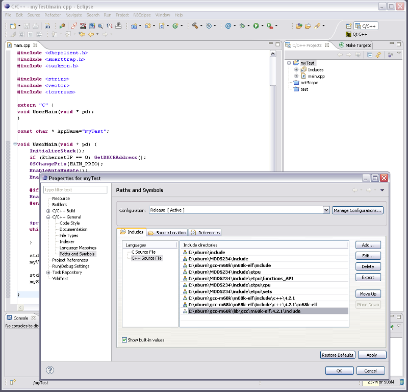

Yep, looks like something wrong with PATH to GCC for ENVIRONMENTS. Don't know why.

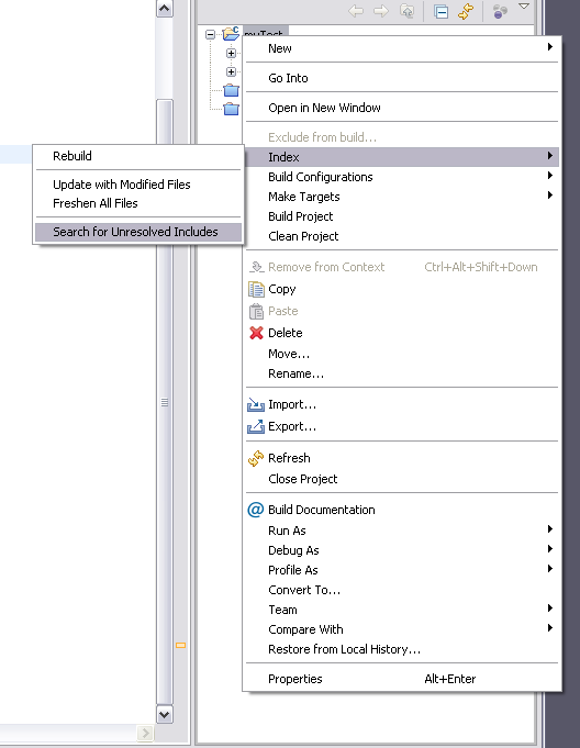

Anyway, you can always manually set whatever it can't find. To see unresolved includes go to "Project/Index/Search for unresolved includes". In my case it was:
I remember you need exact steps, so see screenshots below =)
Best regards.
C:\nburn\gcc-m68k\m68k-elf\include\c++\4.2.1
C:\nburn\gcc-m68k\m68k-elf\include\c++\4.2.1\m68k-elf
C:\nburn\gcc-m68k\lib\gcc\m68k-elf\4.2.1\includeBest regards.
- Check for unresolved includes.
- screen5.png (18.09 KiB) Viewed 6034 times
- Additional includes.
- screen3.png (194.02 KiB) Viewed 6037 times
- Code assist suggestion for std::string
- screen4.png (152 KiB) Viewed 6037 times
Re: How to get Eclipse's Content Assist with Strings and Streams
fanat9,
Thanks again. Adding the "lib" path seemed to do the trick for me. Much nicer now.
Tod
