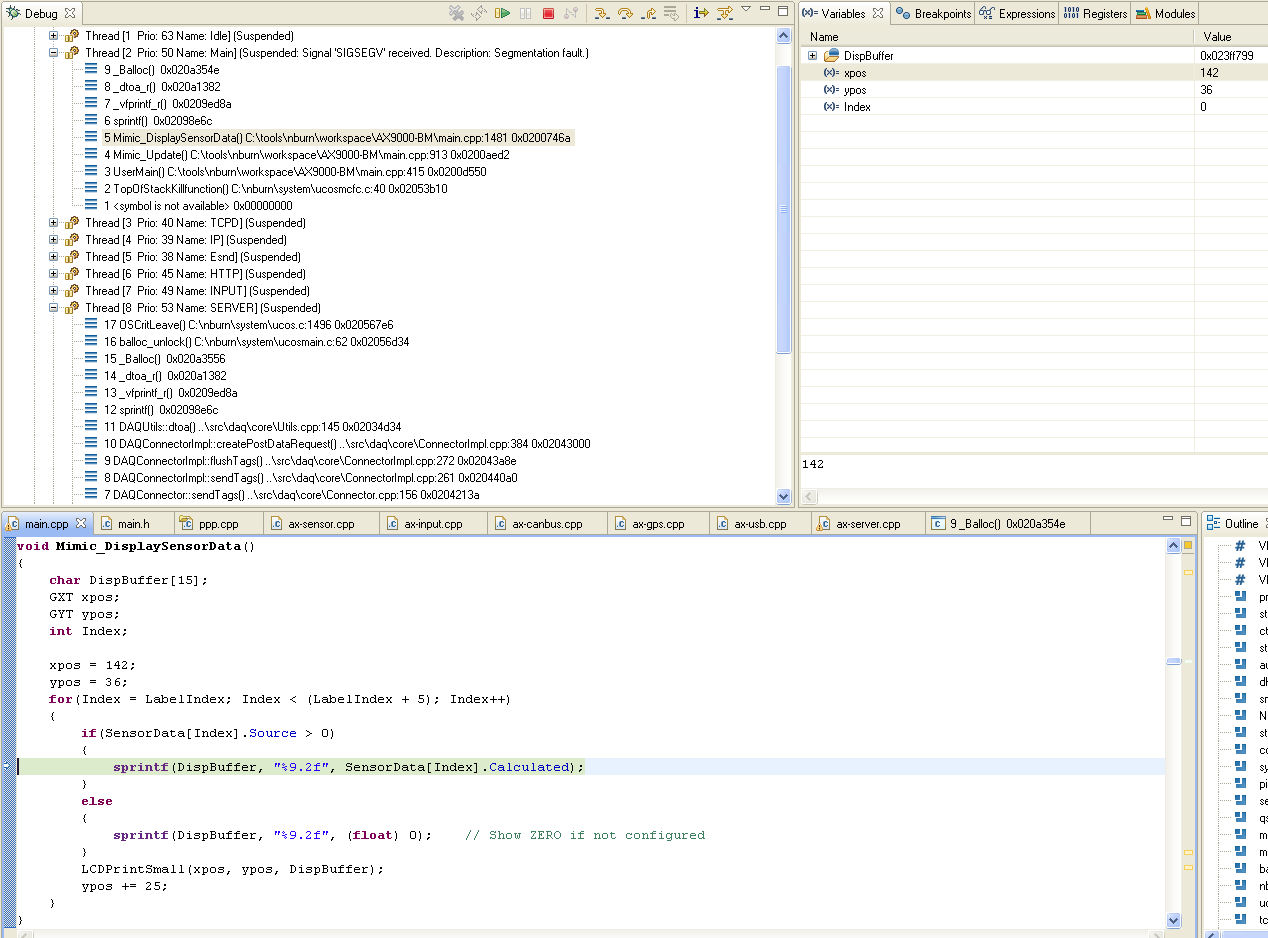

Following on from this, I am still getting this crash. Attached is a view of the debug window when it crashes.
It always crashes at this exact same point but when I check the variables they are all fine and it has just started the first itteration of the for loop. Last night it ran for about 2 hours before crashing, the night before it was about 6 hours.
When you stop debugging, the MTTY output shows a Faulted PC value that points to Ethernet.cpp as show in the previous post.
I have checked all code and can not find anything that could potentially be overwriting memory.
I have disable the call to DAQConnect sending to see if this is the cause of the crash.
- NetburnerCrash.jpg (211.62 KiB) Viewed 4941 times

The SensorData[x].Calculated is indeed a float so this is OK. The strange thing is that looking at the code when this crash happens, the loop has just started and the index is ZERO and the DispBuffer has not even been written to at this point. It still contains garbage from the stack.
I have disable today the calls to send the data over GPRS to the server via the DAQConnect calls. It has been running now for over 15 hours and no crashing. I suspect the DAQ connect libraries are the issue here and maybe that sprintf is not type safe or at least not thread safe although there is what appears to be a lock on balloc.
I'll start by re-writing a lot of the code to use the newer type safe libraries for my string handling and see if this improves things.
The issue I have is the DAQConnect library is supplied as compiled only and no source and it appears to be using sprintf. I am wondering if this is re-entrant? The lock on balloc would suggest so.

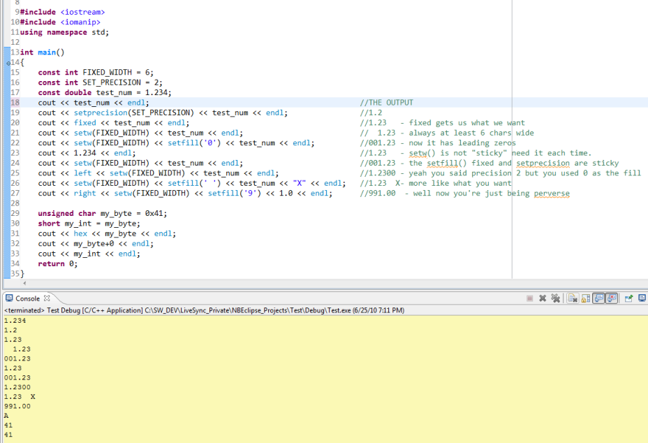

The Wiki article talked a little about io format specifiers in previous paragraph on using cout instead of printf. I orignally gave just an example on how to do two fixed decimal places. I updated it with more examples. To save you the trip I'm attaching a screen shot of the new example code.
Glad you're making the attempt. Even though I didn't mention it in my post, the trap information about where a fault occurs is only useful sometimes. Certain bugs (notably buffer overruns and re-entrancy issues) tend to cause a crash sometime after the offending code. Make sure you are not using the NNDK RC7a release. It had a known reentrancy problem with floating point IO.
- cout_examples80.png (128.26 KiB) Viewed 4897 times
