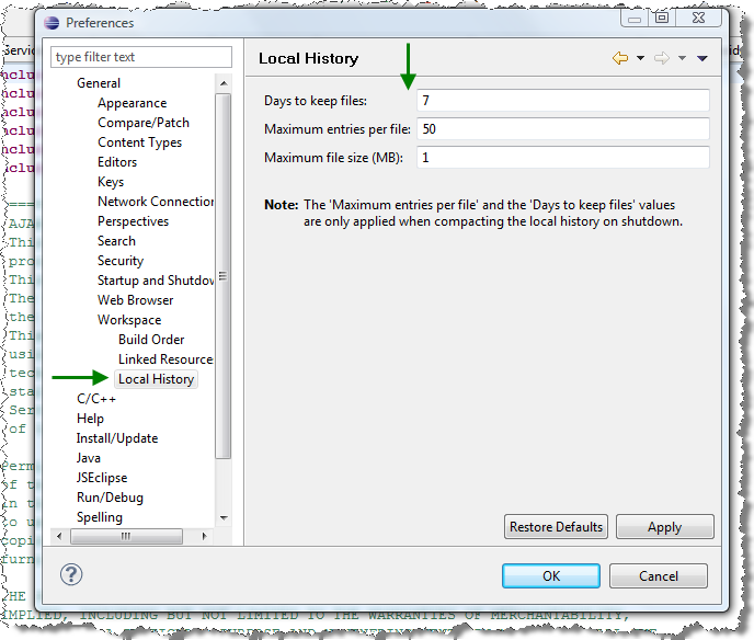

I would suspect that the .history folder is where Eclipses stores the "local history" files. I've found this feature handy when I'm not being good about doing frequent check-ins to SVN. Eclipse automatically takes snapshots of files as you edit them and then allows you do compare your current version to any of those captured snapshots. You can control the disk space usage inside Eclipse. Use Windows->Preferences->General->Local History. See the attached screen shot

- LocalHistory.png (75.8 KiB) Viewed 3398 times

Thanks for letting us know, i will turn that down as i dont use that feature.
