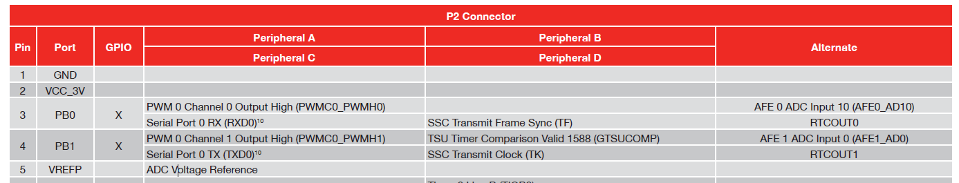

A good reference for GPIO is the data sheet GPIO column. Vref is an analog input, so it is not GPIO. I've attached a screen shot of the data sheet.
- Screenshot 2024-07-24 085331.png (46.67 KiB) Viewed 71518 times
