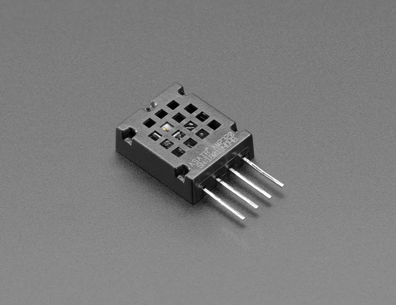

Hi everyone,
I'm working on my MODM7AE70 I want to use I2C to implement a temperature and humidity sensor(Adafruit_AM2320), But I am very new to using I2C, I looked at the Netburner examples to better understand the use of I2C, but I only got confused, has someone implemented this or has experience with the use of I2C? or have you implemented the sensor? I would greatly appreciate your help or any example you can provide.
kind regards
Fredy
Sensor Image
