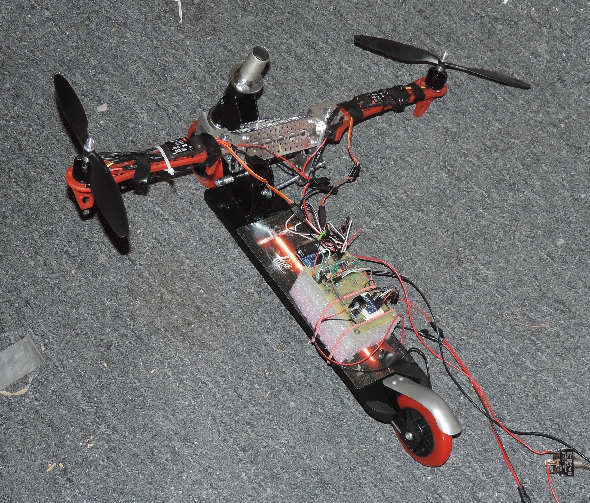

I was originally going to make a quadrotor drone - but then the FAA decided to require registration, I have a commercial pilots license, and so I didn't want to risk a problem with the feds and put that license risk if the drone broke a window. So I decided that a self balancing scooter would be the way to go. The gyro is an Invensense MPU-6500 available for cheap on Ebay and the processor is a Netburner MOD5213 module.
The processor controls off the shelf Mystery 30A ESCs and RHD 2212 brushless quadcopter motors driving 10 x 4.5 props. Right now I have it connected to 12V power supply – but it will use a lithium battery in practice. The rotor mounts tilt on bearings and, after I mount a 1/4 scale servo, it will capable of "tiltrotor, forward and reverse propulsion. The idea is to eventually get to a man carrying, recumbent, highly aerodynamic (think competition glider fuselage) that will travel 120 miles on a 5KWH battery. I figure that people will need to retain their large gasoline fueled vehicles for suitable missions so a second vehicle for efficient individual commuting needs to be small and cheap. It can't be cheap if it is a full size car with a $50,000 battery. My target is 746 watts, or one HP, at 60MPH using 2 x 2000 watt BLDC motors for balance (especially when stopped) and propulsion. An athlete can produce about 500 watts and a recumbent bicycle with a fairing recently set an 85MPH speed record. All I want is 60 MPH.

Excellent points. So I have a new idea. Ebay treadmill motor and Newtonian mechanics applied to a bicycle training device. Treadmill motors are sold cheap (I just bought one) and are characterized by large rotating mass and a flywheel. Imagine a bicycle with the treadmill motor and flywheel slung below and attached to the bar running from the steering bearing to the seat support – then connect the accelerometer/gyro microprocessor control and H bridge. You sit on the bicycle straight up at a standstill and turn the system on. You put your feet on the pedals. If the bike leans slightly in one direction the motor torques such that its Newtonian opposite reaction, the flywheel provides a "quasi rigid" mass in space to react against, turns the bicycle such that the tire contact restores it to the upright position – the motor/flywheel, controlled by the accelerometer, gyros, and MOD5213 processor rapidly operates forward and reverse to maintain balance. As you start pedaling forward the speed is sensed and the gain is reduced. Besides novelty it replaces training wheels in teaching kids to ride bikes. The kid is confident because the bike stays up at a standstill and smoothly rolls off. The parent gradually reduces the gain until the kid can ride. Note that a treadmill motor will produce 5 – 10 foot pounds of stall torque at 24V – more then enough to reactively kick a bicycle over a couple of inches. I have a massive H bridge to drive it and it will use RC style lithium batteries. More info when the motor gets here. You can prove the concept - if you have ever run a substantial DC motor on a bench that is not bolted down - notice that even without a flywheel it tends to flip over in the opposite direction when started. I intend to harness this flipping tendency.

While the theory sounded good the balancing wheel has problems of it's own. There is a vibration feedback, it vibrates really hard, and this is like too much mike gain on an auditorium PA system. Unwanted oscillation. If you turn the gain down (change software multiplier) and increase the exponential filtering the vibration stops but then you don't have enough torque fast enough to roll the scooter. That is illustrated in the video. Had the flu and have not done much but this is going to require some sort of vibration isolation and digital filtering to work.
In addition - the motor is way too heavy. I need a large RC BLDC with a steel disk instead of a propeller so I am going to work on that.
Unlike the propellers - this was not an instant success.
