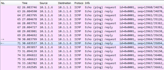

Connection is direct connection.
laptop (10.1.1.6) ------ MOD5270(10.1.1.1)
ping 10.1.1.1 -t (from 10.1.1.6)
I used wireshark to see what is going on and I did see periodic arp request from laptop. But it doesn't seem arp table update delays any traffic flow. It shouldn't affect echo reply response time (by MOD5270) for echo request (by laptop). Even if arp update delays traffic flow, it may delay intervals between echo requests not shouldn't affect echo reply time by MOD5270 for echo request sent by PC.
Anyway, in order to rule out any possibility of arp cache, I added static arp entry and confirmed (with wireshark) there is no more periodic arp update.

After static arp, continuous ping restarted and same periodic delays observed.

With wireshark, I confirmed the delays are caused by MOD5270
Same seq number is a pair of echo request/reply
the response time is less than 1ms for packet pairs of 62/63, 64/65, 66/67, 68/69
But it becomes around 500ms for packet pair of 70/71
and it becomes less than 1 ms for 72/73
And then there are constant longs delays for the following packet pairs...
Wire Shark Capture.JPG (84.18 KiB) Viewed 12995 times
My main focus is serial link and I am not sure if this delay on ICMP packet means anything to serial link.
I would appreciate any explanation if this kind of delay won't occurs on serial to serial (read and write) .
Thank You

Guys
I found out what the cause was...It is not MOD5270. (also not arp update, not subnet/mask,...)
I almost went wrong direction. I had 100% of packets being around 1 ms response when I have my laptop ping a linux pc (with direct connection)... So I almost pointed my finger to MOD5270 because ping delays seemed to only occur when my laptop ping MOD5270.
But just in case, I added Netgear Hub between MOD5270 and laptop so that there is no direct connection between MOD5270 and laptop(win7). And all ping results were less than 1ms. (in fact, MOD5270 response time seems faster than linux PC...which is supposed to be as RTOS is faster than debian linux)
Maybe, I should've used cross-over ethernet cable Vs straight???(If that is the case, it shouldn't work at all???)
As I confirmed MOD5270 is fast, I am no longer interested in further digging into the problem.
However, any further comments are appreciated.
