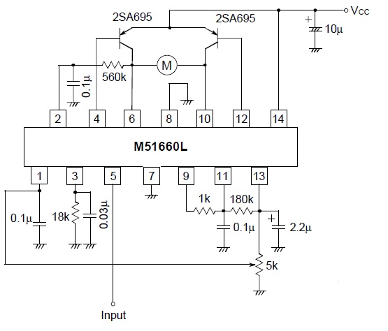

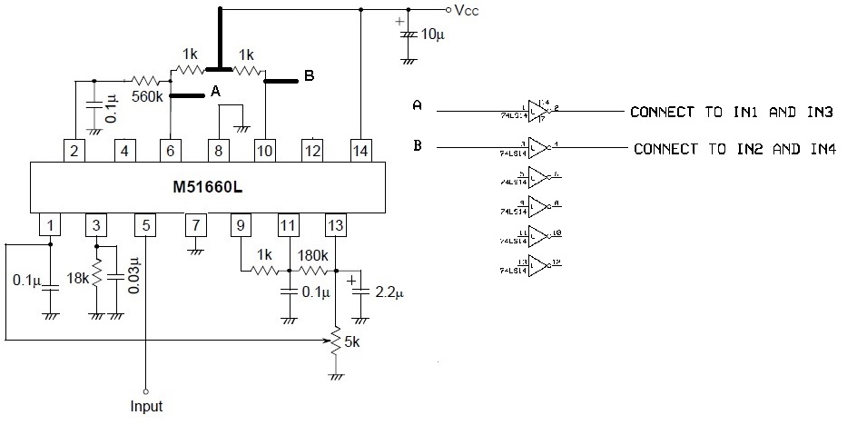

The servo control uses the M51660L servo chip shown in the pictures. It is usually applied to drive small model airplane RC servos and incorporates an H bridge with external PNP high side transistors as shown. I also show my modification in which I just use the lower half of the H-bridge (that is in the chip) with 1K pull up resistors to generate logic signals which can drive BTS7960B or L298 H bridges. The bridges are available on Ebay cheaper than you can make them. If you want bare or completed circuit boards I can make you a deal !
The bottom picture is the original - the top the modification. Ignore the Schmitt triggers - they were deleted.
Note that instead of the 1K resistor between pin 9 and 11 I use a 470 ohm in series with a 2K pot. This allows tuning of the deadband. The 5K pot is the feedback potentiometer driven by the servo motor.
