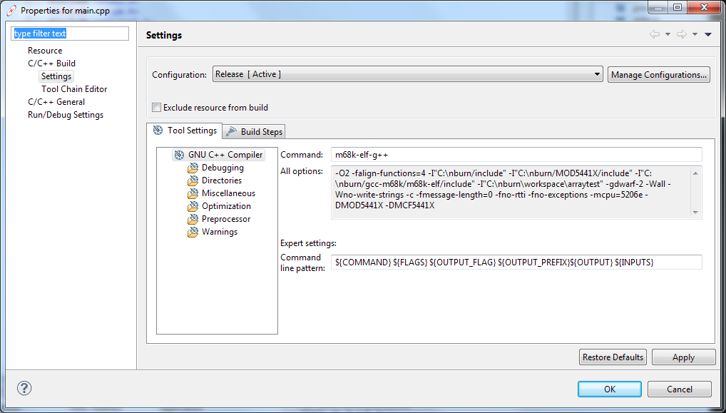

I have not run in to this as you describe it. Are you sure your project is of type "NetBurner project" and not a c/c++ project?
Right click on the source in question and look at the properties. Is the checkbox to exclude enabled by chance? Does your properties page look something like my screenshot?
file properties
file properties
