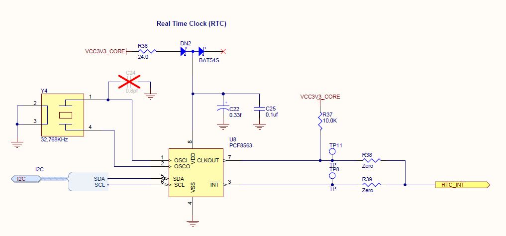

What kind of time drift do you typically see from the PCF8563? I'm noticing that I'm getting about a 6-7 second drift just overnight of it running fast.
Here's my test scenario. When I power up I check for an NTP server. If I can connect to one then I update SystemTime and then update the RTC using: RTCSetRTCfromSystemTime(); I will then power cycle with NTP access disconnected and observe that the RTC chip is accurate to within ~1 second of my computer. So I know the RTC chip is updated and it is accurate as a starting point.
Overnight I'll leave it and notice the SystemTime drift. So I added logic once per hour to call RTCSetSystemFromRTCTime(); to re-sync system time to RTC time. Overnight I'm still seeing it drift by about 7 seconds. I can then power cycle with NTP access removed and it still comes up ~7 seconds off so I know that it is the RTC chip itself that is drifting.
Any thoughts? Attached is my RTC schematic. The only access I have done to the RTC chip as been through the above library calls.
Thanks!
Scott

This one comes down to the accuracy of your input clock. We've gone through the numbers on this a few times, but what it boils down to is the most accurate you can be is determined by your frequency and the accuracy of that frequency. Since you're using a pretty standard RTC, the frequency can't really change much, 32.768kHz. The crystal we use is 20ppm.
The magic formula you're looking for, that quantifies guarantee-able accuracy is drift = time measured * variation (variation = freq * stability) / Frequency.
So in one day you'd expect in our case
drift = ((24hrs*60min/hr*60sec/min) * (32768 Hz *20/1,000,0000))/(32768Hz) = 1.728
So the maximum drift you could expect from a 32.768kHz crystal with that 20ppm accuracy is 1.728 seconds lost or gained per day.
We ran into much the same problem you were having. Our accuracy was pretty bad, usually on the 6-7 secs per day order or worse. Essentially what we ended up needing to do is crystal tuning. Just take a google search cystal selection and tuning with and without respect to real time clocks and you'll find a number of good articles on the subject. If you want a quick an dirty sort of approximation of what you might need, as long as your crystal routing is pretty clean, your schematic matches ours as long as you change C24 to be a stuffed 24pF cap. Once we had a better value, we ended up not even coming near that 1.728 value above, but again, the value we calculated above is the accuracy value you can guarantee from that oscillator. It may get closer most of the time, but you can't guarantee anything better based on the specs.

Thanks. I'm using a 20ppm crystal here too. Looks like it just needs tuning for the circuit. As I was reading through the RTC datasheet I had a feeling it was going to be down to the clock circuit.
