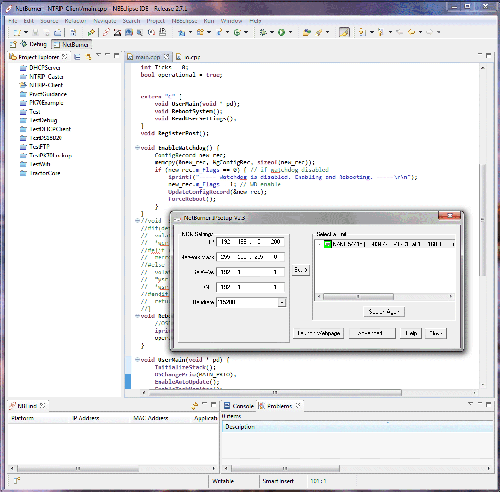

2.7.1 on Win7 x64 with two network interfaces. With both interfaces enabled, NBFind doesn't find my module (NANO) in either NBEclipse or TaskScan. However, the module can be located in IPSetup and AutoUpdate. When I disable one network interface in Windows, everything is fine. I don't recall this being an issue with 2.6.7.

With regard to NBFind: Is this the Eclipse find or the standalone find utility?

dciliske wrote:With regard to NBFind: Is this the Eclipse find or the standalone find utility?
The one in Eclipse. Both of my Windows network interfaces are enabled right now and this is what I get.
