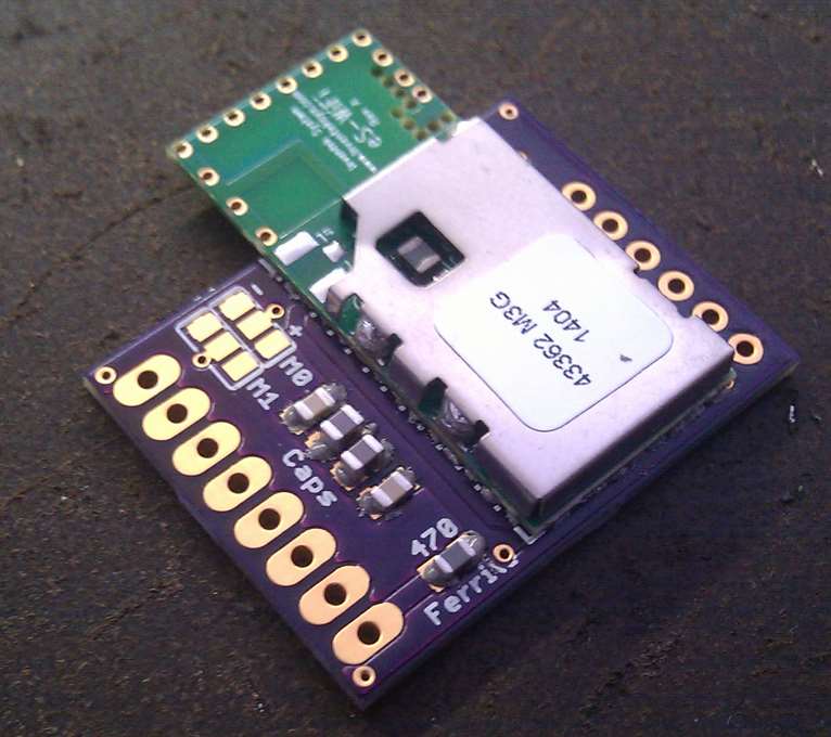

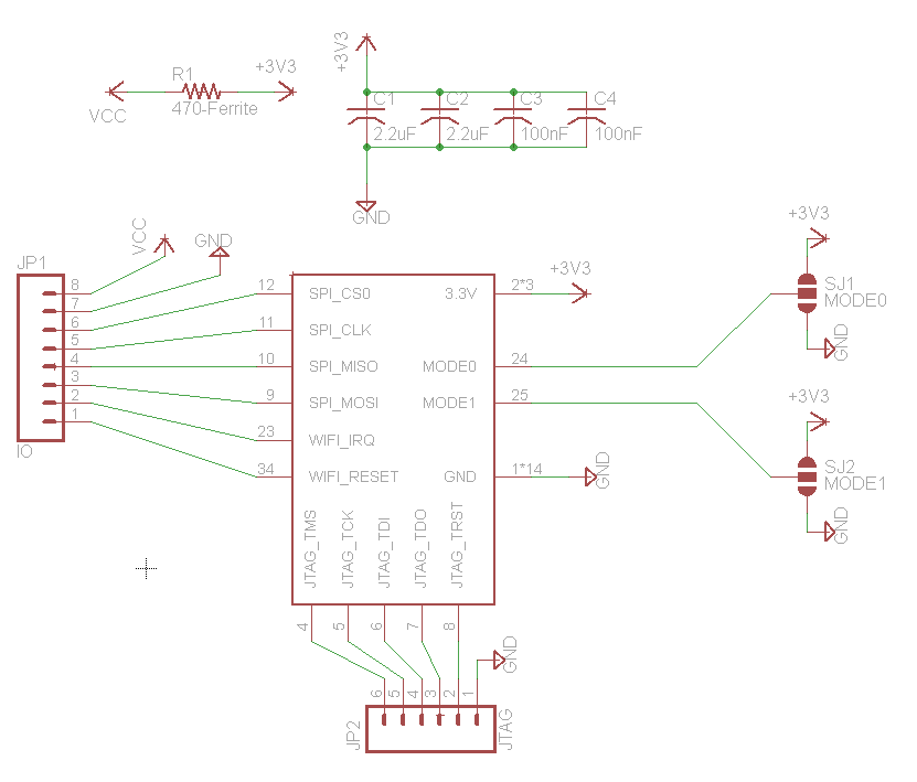

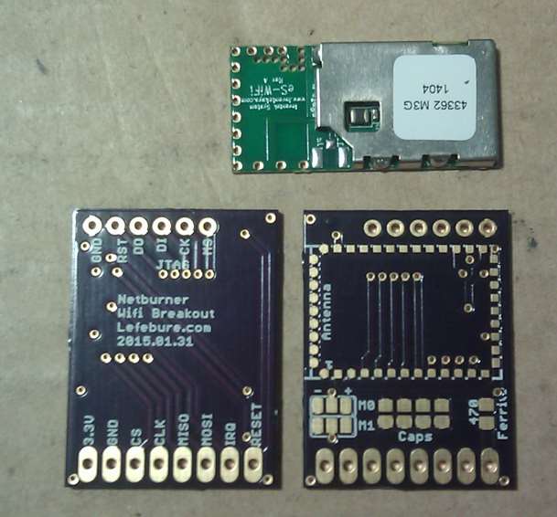

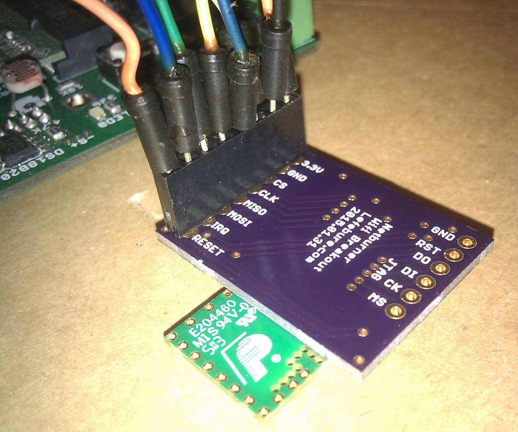

I wanted to incorporate the Wifi module into a future design, but I wanted to confirm that I had the right connections to make it work before rolling it in to a larger PCB. I ended up making a tiny PCB to connect just the necessary leads for a connection over SPI. Schematic and pictures are below. For use on SPI, mode0 and mode1 get pulled high.
I like the compact size of the Wifi module, but I'm not thrilled about not being able to see what the solder joints look like. Version 1 works great, so I guess my concern is unfounded.

Glad you got it working. I am doing the same thing as well for my project. I too wish they would have chosen a different pad layout for the module. Something like this.

I agree with wanting the half-moon pads, but I'd guess that they would: a) add to the board cost, b) add slightly to the board size, and c) make it harder to do the trace antenna.
Also, Lance, MODE1 should be pulled high as well for SPI. In the current firmware, MODE1 is a "Don't care" for either mode, but is marked as "Reserved" for state 0. This is to allow us to add USB or other bus configuration at a later date (USB might be interesting due to fewer pins, but it'll be slower than SPI, as it will only be Full Speed (12Mbps)).

Dan, just a thought adding them would not add any more cost. you could keep the board the same size Just put the half moon pads at the very edge of you current pads. I do not see how it would affect the trace antenna section since there are no pads there.dciliske wrote:I agree with wanting the half-moon pads, but I'd guess that they would: a) add to the board cost, b) add slightly to the board size, and c) make it harder to do the trace antenna.
This would allow many more people to be able to solder their own prototypes, and small run builds.
