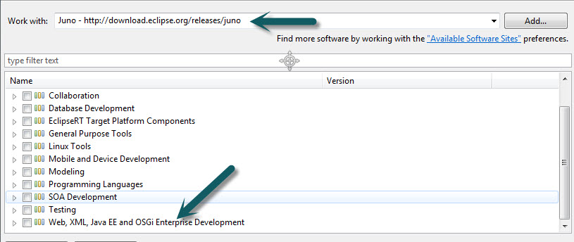

That won't get you a decent HTML editor BUT it's pretty easy to add that manually. Use the Add new software and select the standard Juno release from the Work with drop down. Scroll to the bottom of the list that shows up and open the "Web, XML...." option. (see the image) Near the bottom of that is a web page editor. There are also options for JavaScript development tools. You can also still add in the Aptana suite by adding the following to the available software sites: http://download.aptana.com/studio3/plugin/install -- but it's a pretty heavyweight plug-in.
