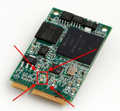

NANO54415
The boot jumper is a pair of circular pads located near the middle line of the board near the connector.
NANO54415 boot jumper location

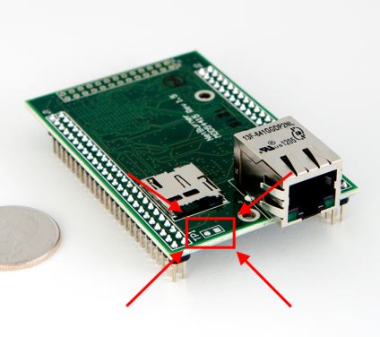

MOD5441X
The boot jumper is the unpopulated header 'TP1', located near the ethernet jack.
MOD5441X boot jumper location
