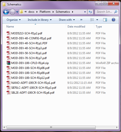

Re: Is there a schematic for the NANO54415 Development Kit
Not sure what to tell you, maybe try re-installing the package.
here is what i have in mine and you should as well.
- 2-8-2013 8-50-26 AM.png (86.39 KiB) Viewed 7995 times
