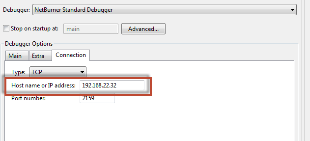

Re: NNDK 2.6 Debugger
I haven't had time to submit a reproducible example to NB. I still have problems. Since you asked, I decided to try again today and I'm running into the dreaded "Error creating session: localhost:2159: No connection" message. I would suggest starting a new topic maybe asking if the NNDK 2.6 Debugger is working for anyone. I'm not sure how many people are using 2.6. I know I'm a pretty bad test case because I use every tool in the C++ toolbox including the boost library, and 99% of my code lives in libraries.
sblair
Posts: 162
Joined: Mon Sep 12, 2011 1:54 pm
Post by sblair »
When I have encountered that before it is just because the IP address in the debugger config settings got lost. Once I re-enter the IP address in all the debugger config settings pane it fixes that.
Or is this a different problem than that?
Duh, I checked and rechecked the IP settings on the first tab but then it finally dawned on me that the message says right in it "localhost", that is no good. So I slowed down and sure enough on the Debugger-Connection tab it had wiped out my ip and put in localhost. I even wrote up a blog entry on OCTOBER 3 of THIS YEAR! Right at the bottom I put a screen shot and this text: Finally, use the Connection tab and make sure the IP Address is set to the address of your NetBurner. This often defaults to localhost which is not going to do you any good. I guess I figured since I'd already successfully debugged this app it would be OK. I figured wrong. Maybe I should read my own blog. Time to run some more tests. Thanks for the heads up.
