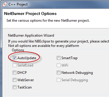

Another choice is to use the AppWiz project builder from within Eclipse. When you do, be sure to include the AutoUpdate code:
