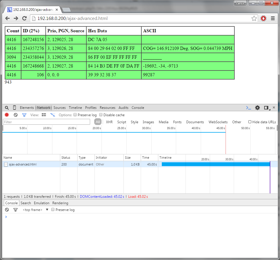

Chrome with the developer tools turned on shows that the page consistently takes 45 seconds to load. The content is returned immediately, but it appears there is a timeout somewhere of 45 seconds before it knows it is finished.

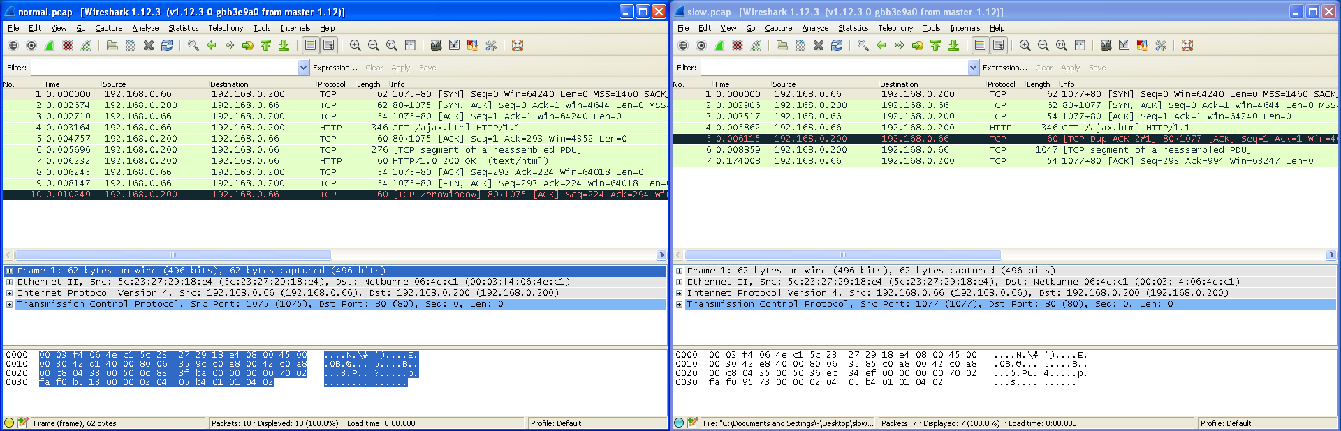

Two packet captures are attached below. Looks like the difference is that on the "slow" capture, I don't get a packet containing the 'HTTP/1.0 200 OK" to close the session.
