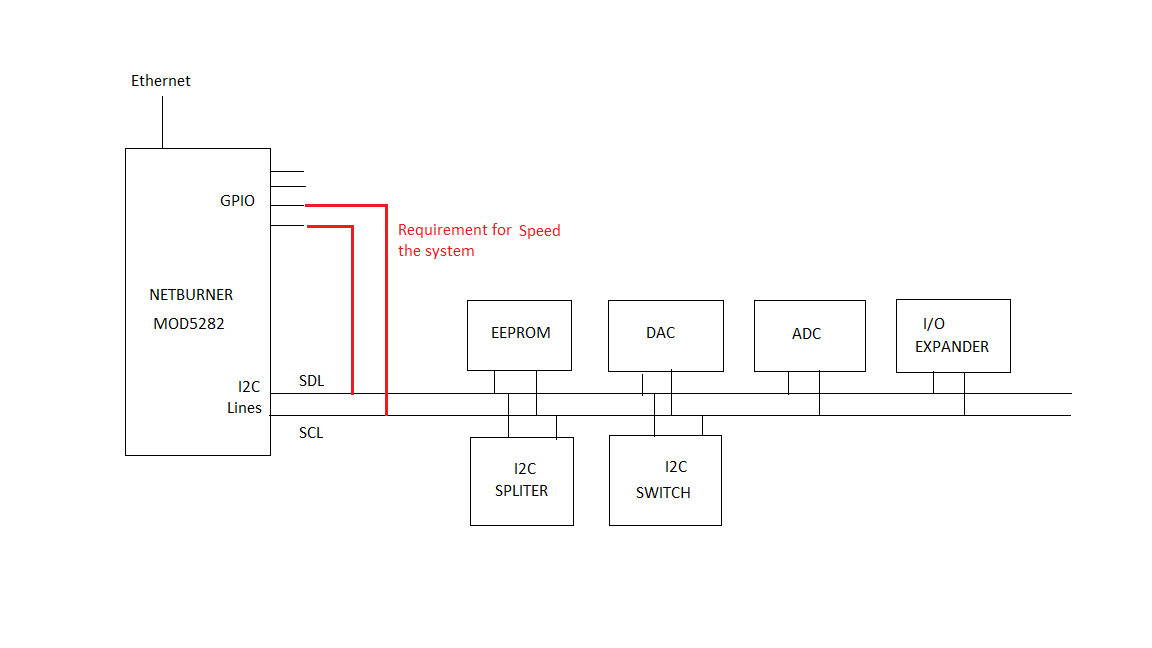

Please go through the attach ckt. I had connected GPIO to i2c bus by disconnecting i2c port of net-burner. but my code is not communicating to the board.
As my board is working on 3.3V. there is a pullup of 5k on i2c lines. i measure the voltage on both line is 1.54V. by disconnecting the GPIO then i found 3.3V.
so i found that the voltage on GPIO is 1.54V. is there any requirement of hardware changes or i have to configure my port in software?

One more thing which we need to take in our concern..........we want to implement I2C clock stretching at some perticular conditions thats why we have to use our MOD 5282's GPIO for I2C communication
Our problem very simple as mentioned in above circuit posted by Ashitosh........If we connect our local I2C to MOD5282's GPIO then NBEclipse is not able to detect the netburner even computer LAN is connected!!!
Is we need any hardware change please advice?

Your shorting something out, and maybe the module 3.3V is being pulled down which is why you don't see it any more. Which pins are you using for gpio? Where are the pull-ups? Is there anything else driving the lines?

Now we have got the 3.3V on ports no other issue. Ports are free only pull up is there & very near to pin. we are tried for different ports like D28 & D30 / A2 & A5 for SDA & SCL lines resp.
We had taken out the i2c bus from main lines & connect the GPIO still board is not detecting.
We had taken a fresh MOD5282 board & used only TCP/IP program still its not communicate.
Whether we have to configure the GPIO ports for I2C lines? Or we need extra hardware to communicate with it.
As i explained in above diagram our system is there. Please advise us.
