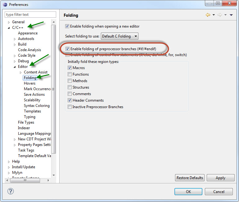

I have Eclipse set up to grey out areas inside an #ifdef or #ifndef that are not complied, and I've commented my #endif s to make it clearer where my blocks are, but somewhere I've got an extra unmatched #ifdef that I cannot find.
Eclipse will highlight a code block if you double-click to the right of the { or }. Is there a way to get it to do similar thing with #ifdef blocks?
Sam
Re: Finding the other end of #ifdef blocks
Yes. See the image.

Thanks Tod,
Another useful feature I didn't know about. Seems you can also do Ctrl-<Numpad/> to toggle it on and off.
I actually wanted to be able to have the block highlighted, not collapsed, but I think this would have helped me find my mis-matched #ifdef blocks as well.
I don't know of a way to highlight the folded code. I discovered this folding feature when trying to emulate Visual Studio's region folding, I documented the process for code region folding in Eclipse. The short version is to just combine the trick I showed you here with #if(1)/#endif. Of course it's better to keep your classes short enough that you don't need regions at all, but for some dispatch and mediator classes that can be problematic.
