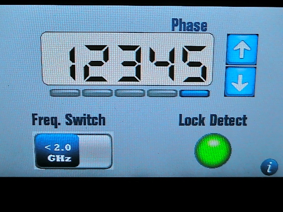

This is a fairly new touchscreen from Matrix Orbita the GTT480272A. I just took a screen shot with an inexpensive camera of the simple interface I built so you can get an idea of what it looks like. This is all dreaded "programmer" artwork that I created. There is a low level library that lets you load fonts, draw strings, graphics, define touch regions etc. A Touch region can have an up and down graphic. In my interface you can select any digit and the led under that digit will "light" and then the up down arrows will change the value at the selected decade. The freq switch just goes between two settings and the LED is green or white/gray (off). If you wanted something like a drop down menu you would have to program it yourself.

Tod, so very nice T-screen and I reviewed your blog, good info.
Seemed like alot of coding to display a message. I may have been distracted by the C#, although it looks alot like C++. I think the GTT is probably high-end with really nice drawing capabilities. We maybe in search of more basic text based screen which may could be interfaced with more basic calls, etc. Thanks
