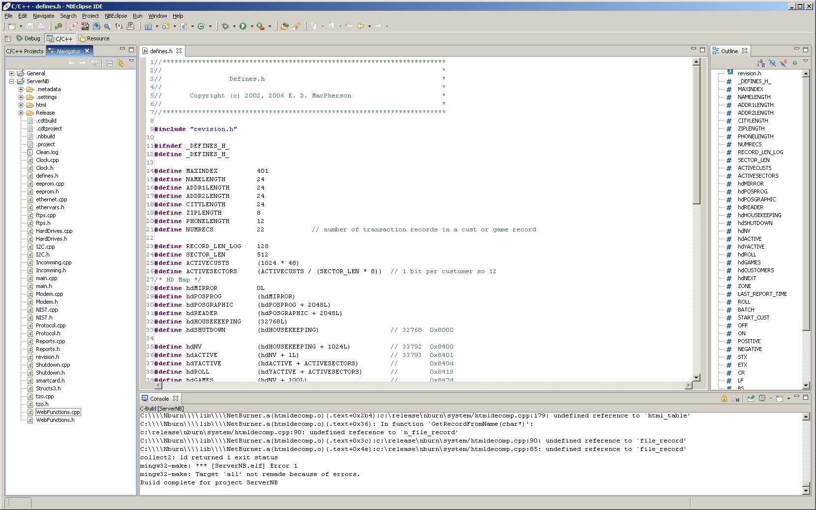

macpherson
Posts: 38
Joined: Tue Jun 03, 2008 10:26 am
Re: undefined reference to `n_file_record'
Post by macpherson »
I am using HTTP. I attach a screenshot of Eclipse.
Ewan.
