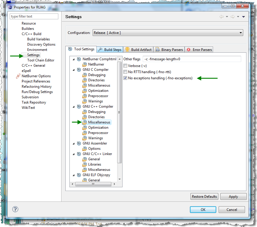

2. I believe exception handling is turned off by default so if you want to try/catch you need to remember to turn it on by clearing the checkbox as shown in the image.
- ExceptionHandlingOff.png (143.2 KiB) Viewed 4995 times
