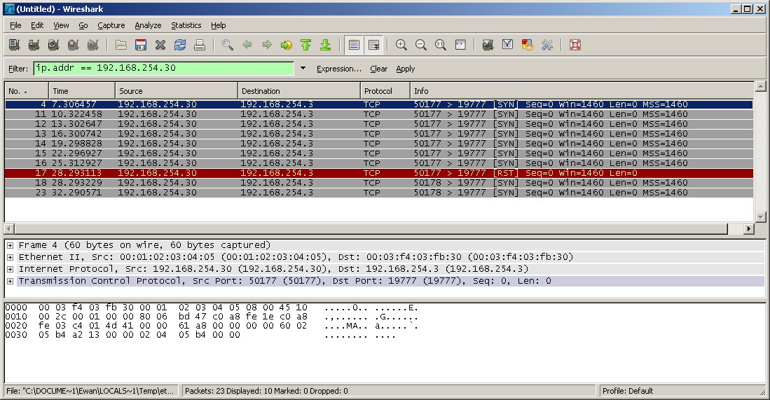

The device sending the packet is not a PC, it is an MCF52233. It worked just fine when the "network" code was in the "UserMain" without anything else blocking. When it currently sends a packet it gets no reply from the NetBurner for a long time, but it does not give up until the connection is successful. I have attached a WireShark image.

I noticed that the MAC address of the target (the netburner) is visible in the wireshark image (above). I idly checked the netburner MAC address lable and, lo, it was different. How could this be?
I had had a netburner module which died afer the MCF52233 had been set up for its target to have the fixed IP and MAC address of the MOD5270. I just replaced the bad MOD5270 with another and uploaded the software. Never again will I disable ARP!
I changed the MCF52233 to doing the ARP thing and all is working. The question which begs to be asked is "How on earth did the MOD5270 EVER get the data, even after 20 minutes?".
