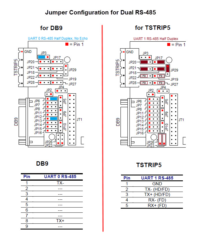

Tom, another question,
If I'm doing RS-485 on both ports, the JP23/JP26 termination resistors only apply to the TSTRIP5 correct?
Are there no termination jumpers for RS-485 on the DB9?
NetBurner Jumper Configuration for Dual RS-485.jpg (143.05 KiB) Viewed 72504 times
Tim
Posts: 616
Re: CB34EX JP23 / JP26 Description
Hello Tim,
That is correct. If you want termination on the DB9, they need to be added to the connector or cable.
