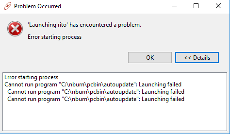

I'm currently trying to get a mod5234 up but I'm running into issues running the program. I encounter an error regarding the autoupdate (see error dialog below)
I've manually run the autoupdate app and successfully programed the netburner. I've given my account complete permission and have tried running the application in admin mode as well but I keep getting this error. What could be the root cause?

Eclipse tries to launch the same autoupdate.exe as you did in your manual tests. My first guess would be that there is some type of antivirus or firewall on your system that is preventing one application (eclipse) from launching another .exe (autoupdae).

I ended up just installing the latest IDE and everything worked out.
