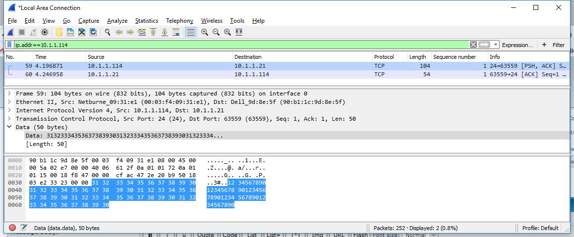

To reduce the number of variables I would try the following:
1. Connect the SBL2e serial port to your computer
2. Run a serial terminal like our MTTTY
3. Create a text file with 50 characters
4. Use telnet to connect to the SBL2e. Now anything you type in telnet goes to MTTTY and vice versa.
Type some characters to verify it is set up correctly.
5. Start the wireshark capture
6. In MTTTY use the Transfer->Send Text File option to send your text file
- SBL2ePacket.jpg (104.31 KiB) Viewed 21826 times
