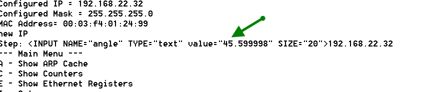

Re: sprintf formatting question
re:
Also, doesn't NetBurner support the safe version snprintf? Shouldn't everyone that doesn't use the C++ iostream library being using the safe versions instead?
And maybe finally something useful: what you posted shouldn't even compile. Did you cut and paste or do it from memory? You're missing escapes on the final size = 20. When I correct those your code compiles and works for me on a MOD5272. Here's the code
Here's an image of the output:
Sure, use the C++ iostream library instead. (sorry, I have a reputation to uphold).Any ideas?
const int MAX_MSG_SIZE=100;
char msg[MAX_MSG_SIZE];
float float_val = 45.6;
snprintf(msg, MAX_MSG_SIZE,"Step: <INPUT NAME=\"angle\" TYPE=\"text\" value=\"%f\" SIZE=\"20\">", float_val);
printf ("%s", msg);- Attachments
