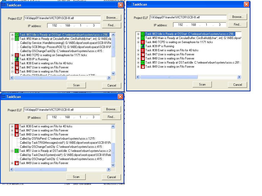

I have a question with TaskScan.
I'm trying to debug a code that is failing, so I'm trying to use taskscan. on two different machins it behaves differently. one one PC it shows "+" signs to display more info, on the other PC, I don't get those "+" signs. Why is this?
In the one the shows the "+", I see a list of function calls, like a tree. How do I interpret that?
I'm sending a jpeg of the TaskScan output. They are all from the same instance, the one to the right is with the "+" contracted. The ones to the left are expansions for two different tasks.
Once somebody helps me understand this, I'll post a question on my failing code.

Re: Interpreting taskScan
The + sign lets you see the call stack from your application. If you scroll to the right you'll see the line numbers from the source code. So for your main task #50 you have a classSCB3Msgs with a method ProcessROET() that called Service::HandleIncoming(). Everything else is pretty much explained in the NetBurnerTools.pdf manual in Chapter 13. TaskScan.
I'm not sure why on one computer you couldn't see the + symbols. Did it show little dots or a blank area. Maybe it just couldn't show the icon. You could always try clicking where the + should be.
Hi Tod,
I read the NetBurnertools.pdf, and it shows how to use it, but does not even mention or show the + signs. what is shown in their manual is what I see in one of the PCs. I clicked on the colored task icon, and nothing. I clicked on where the + is on the other PC, and nothing.
Anyway, on the PC that does show the + signs, this morning I was monitoring a hangup, and the + signs for the tasks I'm interested in are not showing! any idea why? (attached) the other thing is that now I get numbers (program counter)instead of the text that showed the code section.

- taskscan2.jpg (76.87 KiB) Viewed 7055 times
When you get a trap with hex values you use the WinAddr2Line program to find the source code. I'm really not that conversant with TaskScan but you might be able to take that hex value and get a line number but I doubt if it will be that helpful. Also, I generally avoid any directory path with a space. This has historically caused problems. Rename any spaces in the path to your .elf file with an underscore and see if the line numbers show up. The difference between your two posts seems to be the location of the .ELF file.
Hi Tod,
I was able to fix my problem, thanks to TaskScan. I was able to see that the code was not "hung up" but rather cycling through the main task in a place I wasn't expecting. The program counter value pointed to what section of the code it was stuck in. It was stuck in a while loop, caused by a bug I now corrected.
