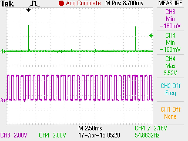

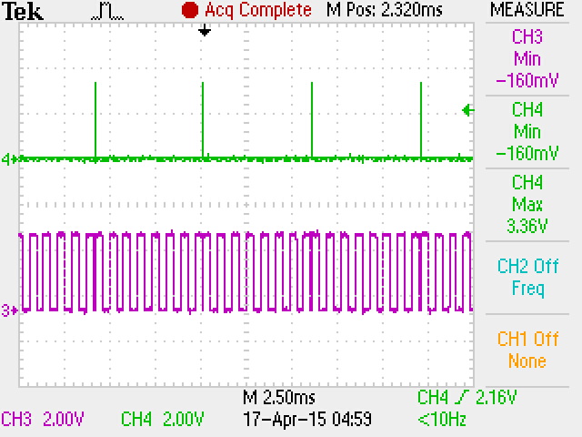

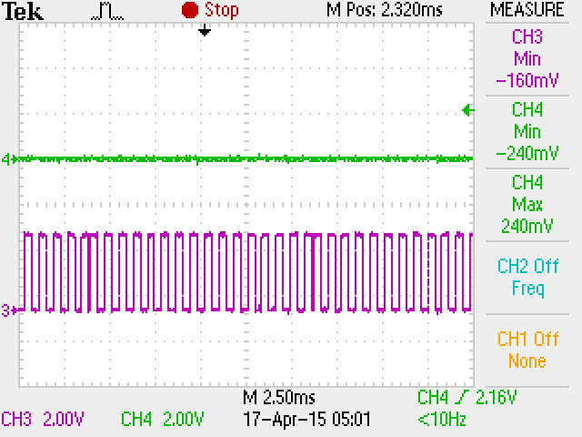

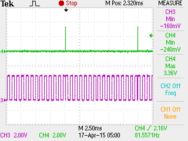

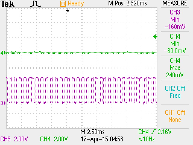

*note the file comment on each picture
24 bit transfer size No DMA
24 bit transfer size DMA
16 bit transfer size DMA
16 bit transfer size No DMA
1000hz 8 bit transfer size No DMA
1000hz 8 bit transfer size DMA
