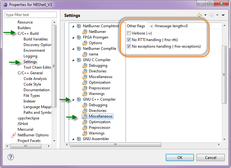

The resolution to the problem strikes me as somewhat strange. Eclipse does not (to the best of my knowledge) automatically turn on Exception handling. In fact, for this project under the project Properties->C/C++ Build->Settings->Gnu C++ Compiler-> Miscellaneous settings (see image) I have the checkbox enabled for No exceptions handling (-fno-exceptions).

I would guess you're seeing the dependency of TcpServer on TcpServerReset. This is what I get for trying to upgrade old code instead of rewriting it. I might have others in there as well. Instantiating static objects like I'm doing here is a VERY BAD idea. I even talk about the dangers of non-local static objects (NLSOs) on the wiki. A case of do as I say not as I do.
The code should take a lazy loading approach and leave the statics null until requested (more of a standard singleton pattern). Not so much to save the cost of instantiation but to to defer the instantiation until after the program fully boots so that this type of linker dependency is avoided. When I get a chance I'll fix the code and reupload it.
