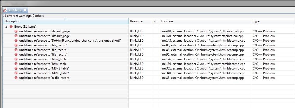

Here's the list of 11 errors I get. Thanks for taking a look!! I need to get this small program working by the end of the day today... Got a few deadlines. Thanks guys!!
- Errors.jpg (181.6 KiB) Viewed 10114 times
Re: MOD54415 Example Program GDB Demo has errors?
You don't have an 'html' directory in your project do you...? Your project isn't creating a htmldata.cpp file, and therefore including those associated data members. Either remove the call to StartHttp() or retry the import, but make sure you include the 'html' subdirectory.
