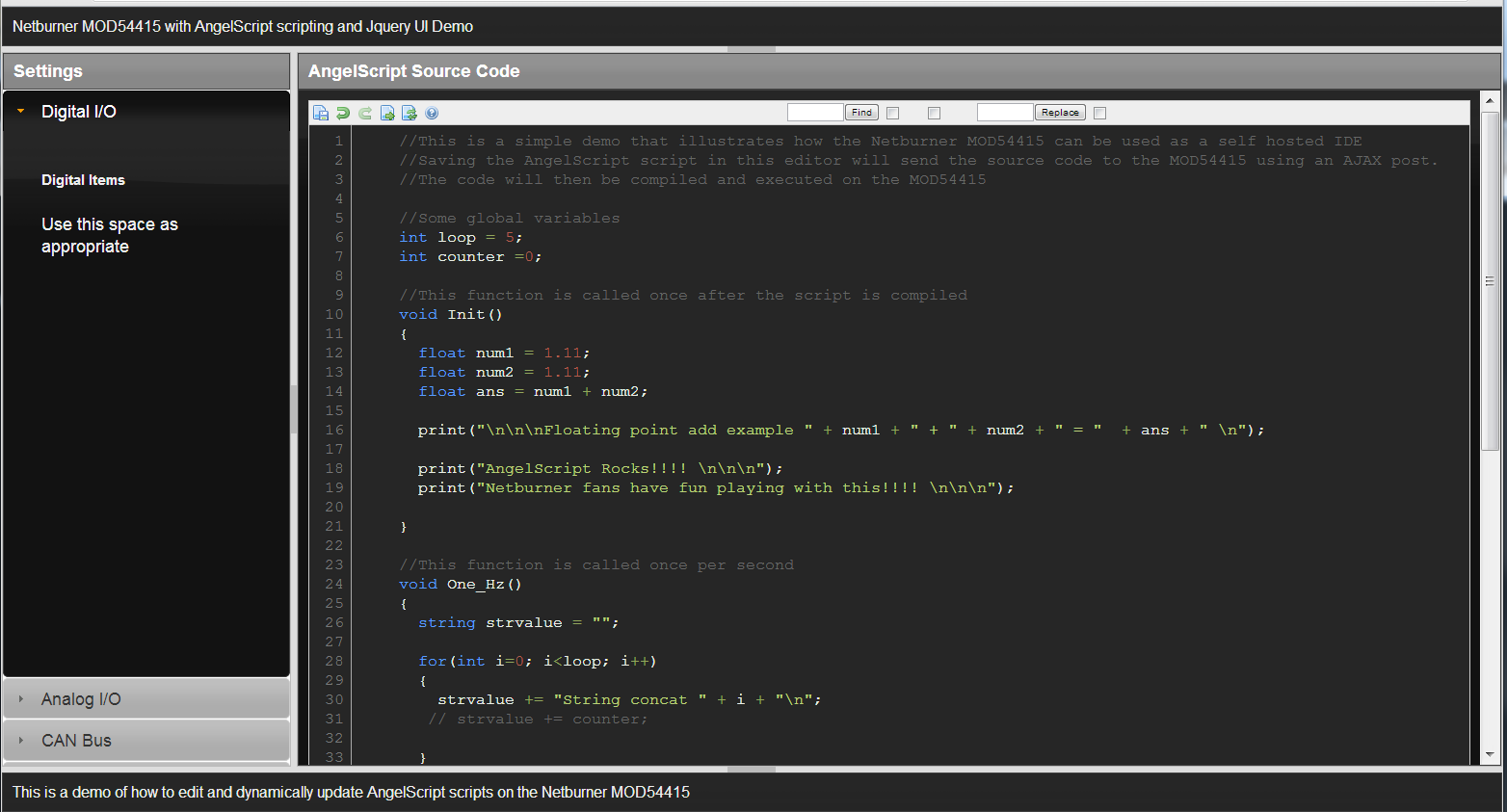

AngelScript is now functional to a point where it is very useful. I have integrated strings and array as well as a print function that sends output to the console. Have fun!!! Most of the remaining work is going to be integrating the Netburner API and the completion of the GUI. I modified the example script to demonstrate how strings, concatenation and printing work.
- AngelScript String Support.png (96.52 KiB) Viewed 10918 times

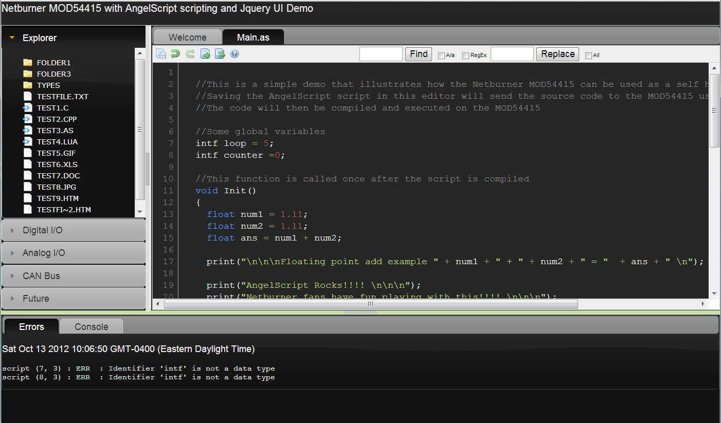

I've added a little more functionality to this project. You now get dynamic feedback when a saved script has errors. There is also a file explorer that lets you traverse directories on an SD card. You can't open the file yet. This is will be my next addition. On the scripting side I have added the following functions
setPin(pinNum) -> turn on digital output (I was use this to fire the LEDs on the DEV board)
resetPin(pinNum) ->turn off digital output
OSTimeDly(ticks) -> pause script (resolution is system tick time)
hrOSTimeDly(seconds) -> pause script using high resolution timer (I was able to get millisecond performance, but would need to adjust the time to account for the function call for precision)
I'm in the process of cleaning up the code and putting things in the proper place. This is a screen shot of the latest front end.
- Angelscript GUI errors.png (122.05 KiB) Viewed 10877 times
