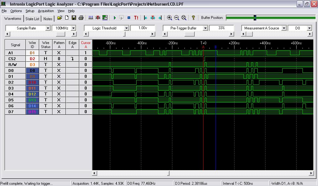

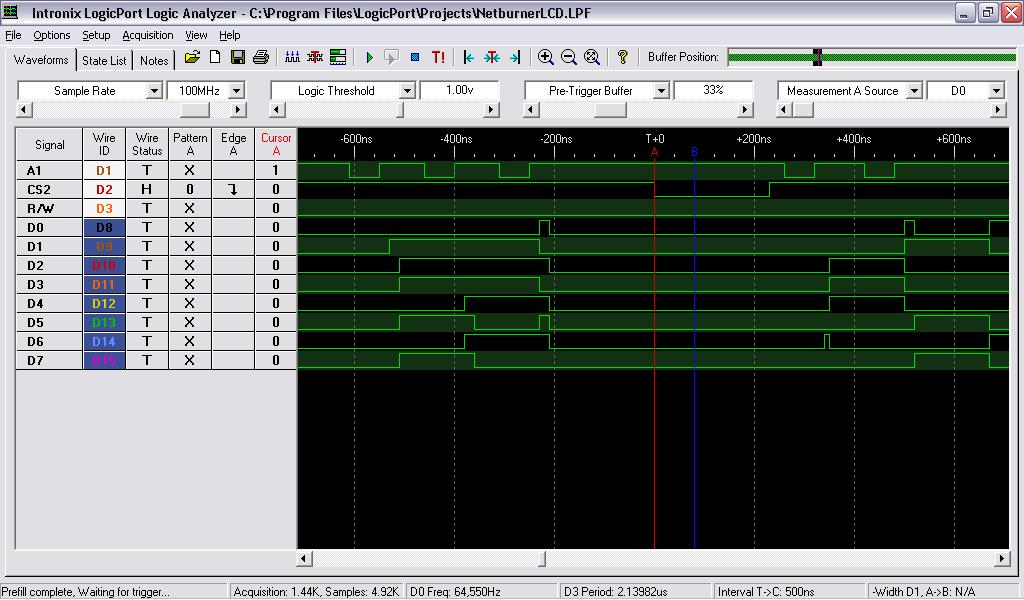

In the attached images you will see the issue I am getting during read of write. I seem to be getting glitches on the CHIP SELECT and I am wondering if my address setup is the issue here. I chose an address that is not used by anything else, at least it is not supposed to be.
The wider CS2 image is the correct behavour and timing wise it works out correct. The narrow one is less than 5ns and the correct width is 210ns. Well within the timing of the LCD.

Correct timing
Correct timing
Wrong timing
Wrong timing

If I single step the code I get randomly the short bus cycle.
Running at full speed and letting the analyser cycle repeat I can see the random short cycles appearing.

Just had a DOH moment.
It was the logic threshold in the analyser settings and setting this to te correct level gives good clean signals. Everything is clean edges and signals.
