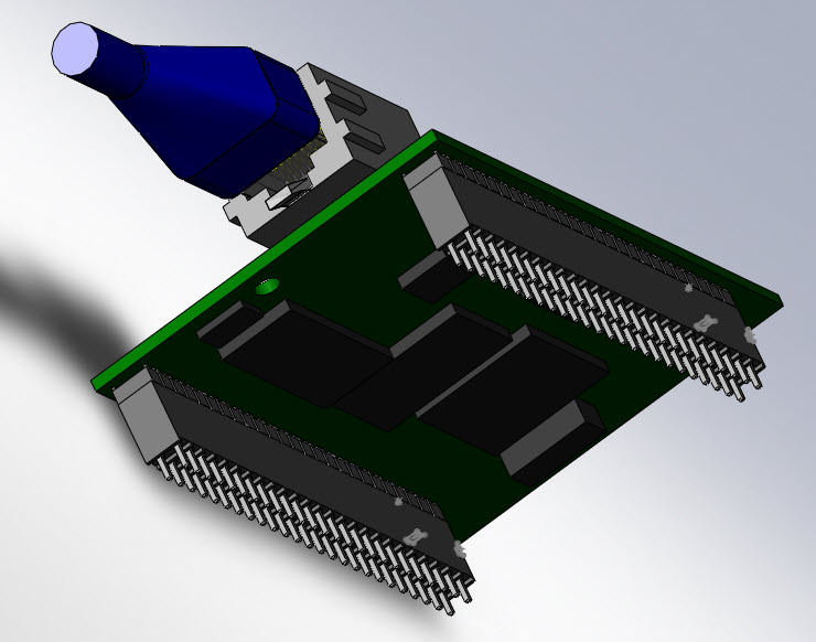

Attached are JPG, 3d-PDF, and a zipped Step file for a Mod5234 showing an external ethernet plug for clearance. The headers are samtec (with one set on the NB board, and a taller lower set intended for the mating board, the pc-mount ethernet jack is halo. The chips are simply estimated by calipers, and the holes, pin locations, and board edge are determined via the NB mechanical print. There is a point at the pin 1 location for both headers at the level of the mating board surface I believe. Obey the caveats of models that you do not build yourself!!

- Mod5234 Assy with Ethernet Plug.jpg (63.38 KiB) Viewed 6753 times

Nice work there RG.. Only downside when I tried to import into Alibre Design was something strange with the RJ45 plug in that is has a face that was way off from the board that I could not edit. Deleting the RJ45 seemed to have cured it and I see that this part (RJ45 plug) appears to have come from 3D Content Central.
I didn't bother with the chips on the underside as even if I place parts under the Netburner, it will still work fine with regards to clearance as the headers are 8mm high as it is..

Re: Eagle netburner library
V8:
The pc-mount ethernet jack DOES extend beyond the edge of the board, and usually that would be important to retain in any footprint even though it has no bearing on the holes in the board like the headers do. In many layout packages, footprints have a concept of extents, usually a rectangular region outside of which the part can't extend. This solid model comes from SolidWorks and since it may not include an extents layer, Altium may balk. Obviously, the extents would need to be bigger than the NB PCB edge. Similarly, most layout packages have heights associated w/each footprint. The reason I include the IC heights is to help insure that other components (eg like a tall cap) placed beneath the NB don't interfere. Often you can move these (non-NB) parts a little and still get them under the NB, although they could not be placed just anywhere.
