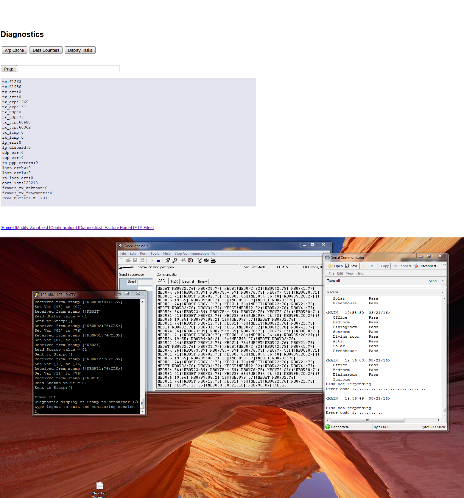

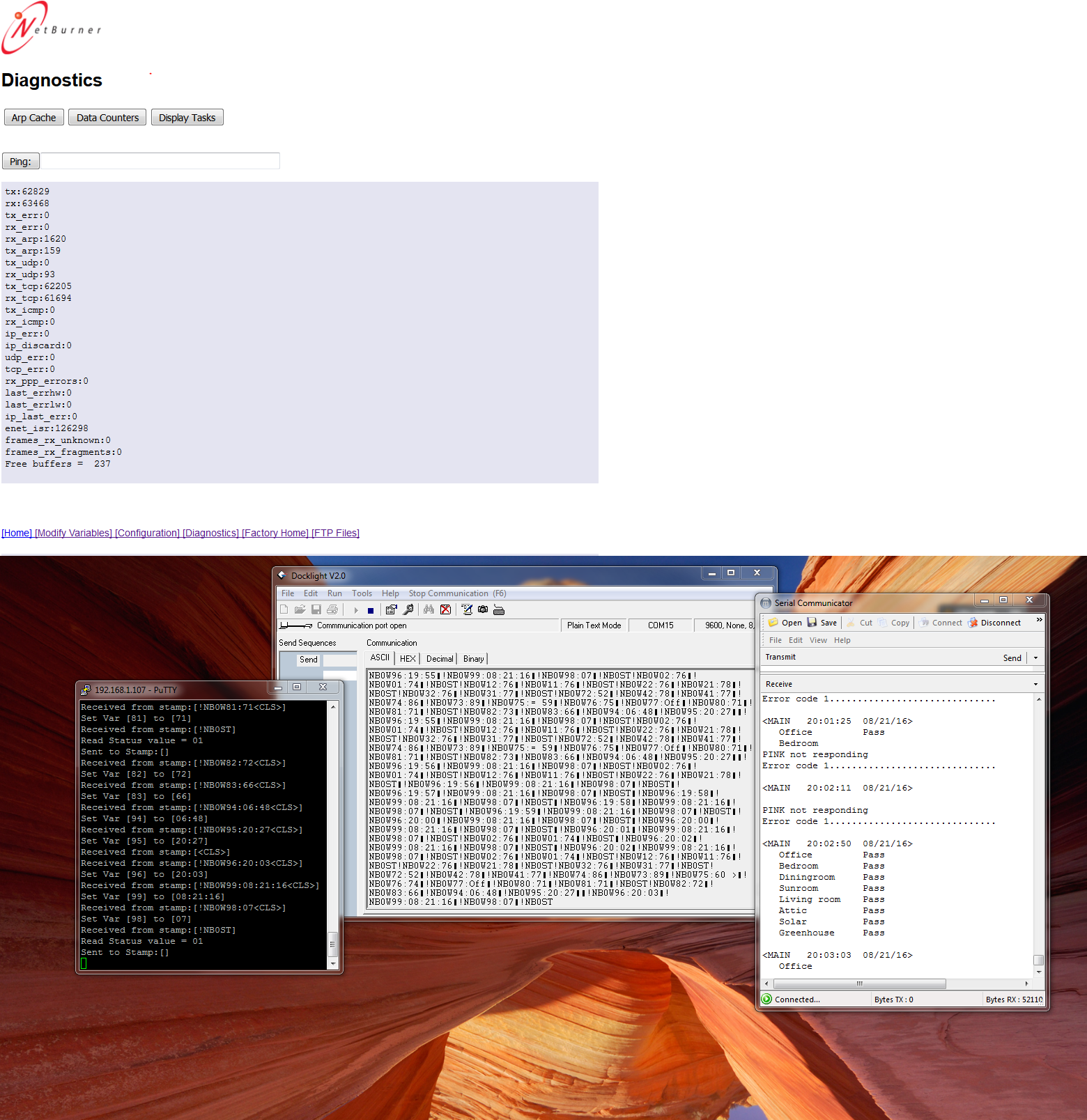

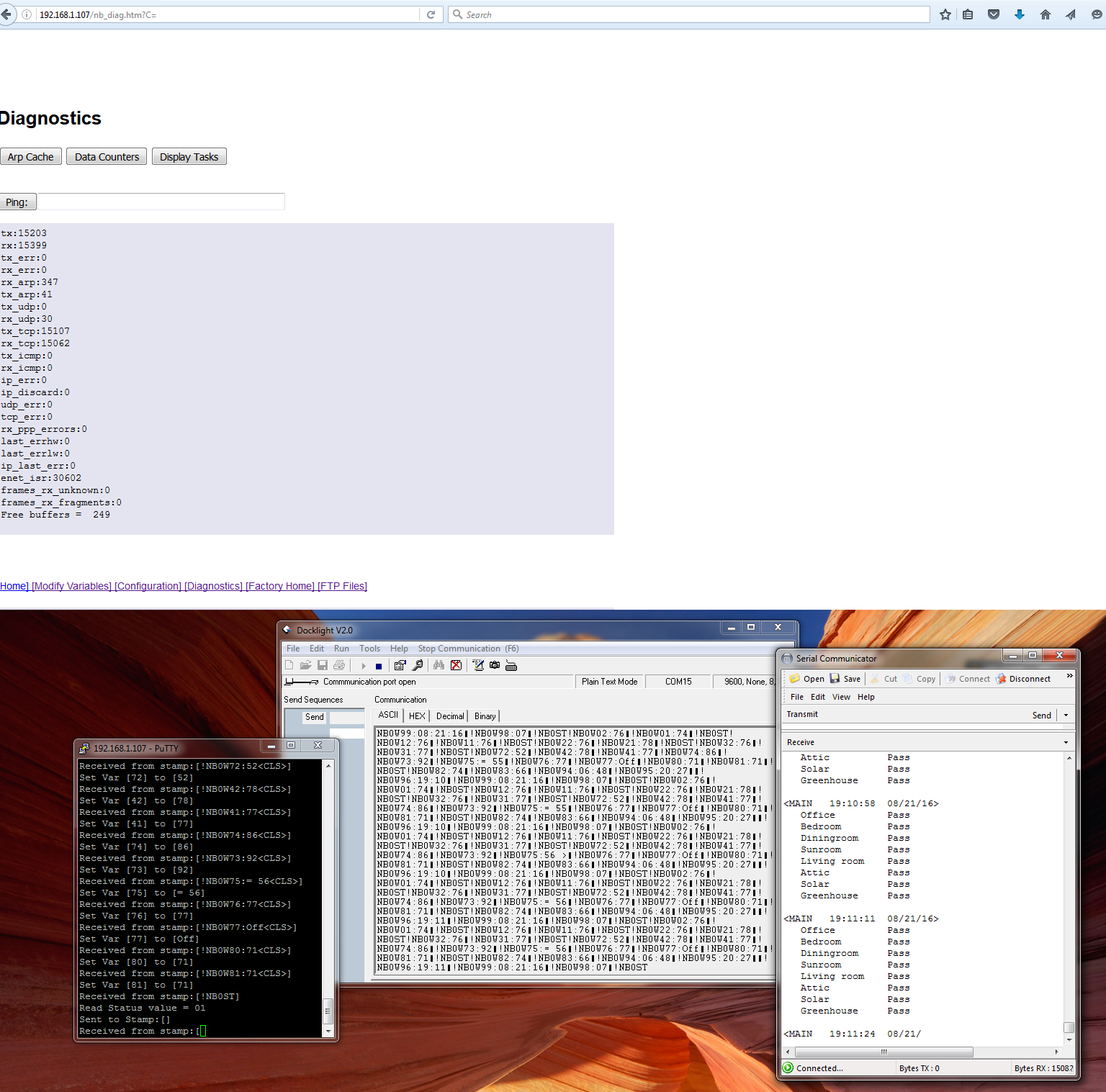

These are screenshots of the Diagnostic page with and without the Error.
Hope these help.
Hope these help.
- Just as the error cleared
- Diagnostics snip error 4 cleared.PNG (1.55 MiB) Viewed 48934 times
- During error
- Diagnostics snip error 1.PNG (1.81 MiB) Viewed 48934 times
- Normal Operation
- Diagnostics screen grab 2.png (947.19 KiB) Viewed 48934 times
