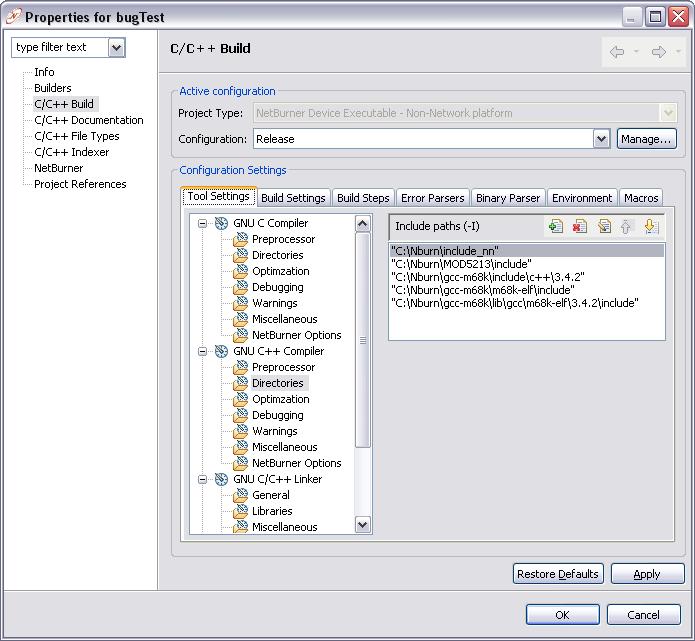

3) I used printf 'cause #inlclude<iostream> won't compile, even though I have added the path
C:\Nburn\gcc-m68k\include\c++\3.4.2
maybe you can help me out.

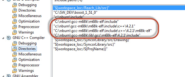

I don't think cout vs printf would matter but your statement about the include path you used was very interesting. I take back what I said about the compiler not changing. Your path indicates you're on gcc 3.4.2 ( which coincidentally is having its 8th birthday today) and the current version of the NNDK uses 4.2.1 (a relative youngster at 5 years old 7/2007).
You may have found a compiler bug that has been corrected. I'm not sure why <iostream> won't work for you though. Just for future reference I'm attaching a screenshot showing the four directory paths I always include for C++. This both allows things to compile and allows the indexing system to have enough information for content assist to work with the standard library.
Re: MOD5213, atof convert"-0.0" to -2.0
**** Build of configuration Release for project bugTest ****
mingw32-make -k all
Building file: ../main.cpp
Invoking: GNU C++ Compiler
m68k-elf-g++ -m5206e -O2 -gdwarf-2 -fno-rtti -fno-exceptions -I"C:\Nburn\include_nn" -I"C:\Nburn\MOD5213\include" -I"C:\Nburn\gcc-m68k\include\c++\3.4.2" -I"C:\Nburn\gcc-m68k\m68k-elf\include" -I"C:\Nburn\gcc-m68k\lib\gcc\m68k-elf\3.4.2\include" -Wall -c -fmessage-length=0 -MMD -MP -MF"main.d" -MT"main.d" -DMOD5213 "../main.cpp" -o"main.o"
Finished building: ../main.cpp
Invoking: GNU C/C++ Linker
m68k-elf-g++ -m5206e -Wl -Wl,-n -T"C:\Nburn\MOD5213\lib\MOD5213.ld" -Wl,-R"C:\Nburn\MOD5213\lib\sys.ld" -Wl,-Map="bugTest.map" ./main.o -Wl,--start-group,"C:\Nburn\lib\MOD5213.a" "C:\Nburn\lib\NetBurner_nn.a" -Wl,--end-group -o"bugTest.elf"
c:/Nburn/gcc-m68k/bin/../lib/gcc/m68k-elf/3.4.2/../../../../m68k-elf/bin/ld.exe: region rom is full (bugTest.elf section .text)
collect2: ld returned 1 exit status
mingw32-make: *** [bugTest.elf] Error 1
mingw32-make: Target `all' not remade because of errors.
Build complete for project bugTest
mingw32-make -k all
- #include <iostream>
won't compile. - netburner.JPG (75.95 KiB) Viewed 6303 times
