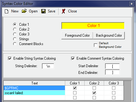

V8: I occasionally use a $25 terminal emulator called indigo that provides what you need: http://www.shadeblue.com/
It supports a"standard terminal mode" and a "direct terminal mode" which has VT100 and Linux support for screen colors, cursor position, and direct kbd input from the window. You can display data in ascii, hex, binary, and many mixed modes. The main reason I like it is that you can customize the display of colors for special strings. That way if printf is dumping lots of strings, and I am looking for a particular string, its easy to see. The following example shows configuration for coloring a specific NMEA sentence from a GPS, along with a different color scheme if a parse of that string failed. It supports many connection protocols: telnet,rs232, ssh, rlogin & others. The only thing I don't like is that it is keylocked to a particular PC. This is a real pain, but they are OK with allowing it to be moved.
- Indigo Color Editor.gif (12.37 KiB) Viewed 10238 times
